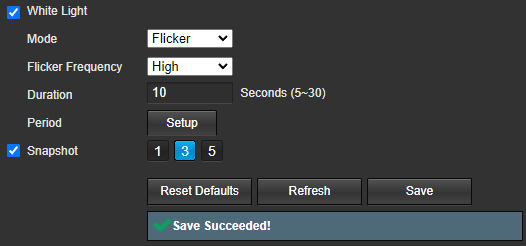

Step 3: In the setup menu, enable the white light option. This will allow the camera to activate the deterrent once an event is detected. Click Save to apply the settings.
White Light: This checkbox allows the camera to activate the white light LEDs once an event is detected.
Mode: The current mode of the warning light LEDs will be set to flicker only.
Flicker Frequency: The intensity of the white light LED after they are activated. Can be set to high, medium, or low depending on the user’s preference.
Duration: The amount of time the warning LED will flash.
Period: Set a schedule for the deterrent.
