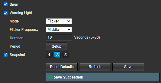

Step 2: Click on Setup>>Event and setup a detection modes. Motion detection will be enabled by default, however, for more information on how to setup AI features, such as IVS , click here.
Step 3: Enable or disable the Siren or Warning Light option to enable active deterrents. Disabling the warning light option will disable the red and blue LEDs from turning on after the feature is triggered.  Click Save to apply the settings.
Siren: This checkbox allows the camera to activate the alarm once an event is detected.
Play Duration: The amount of time the siren will sound.
Warning Light: This checkbox allows the camera to activate the red/blue LEDs once an event is detected.
Mode: The current mode of the warning light LEDs will be set to flicker only.
Flicker Frequency: The intensity of the warning light LEDs after they are activated. Can be set to high, medium, or low depending on the user’s preference.
Duration: The amount of time the warning LED will flash.
Period: Schedule a time in which the deterrents will apply.
