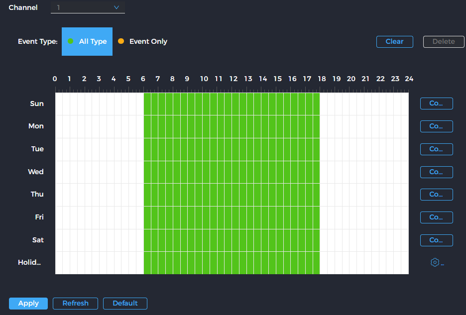

A schedule can be set that will allow the camera to only record or retain snapshots during specific days & times throughout the week. It controls 2 different record types, All Type (continuous recording), Event Only (motion, HVD, and AI events), IVS. For more information on how to create a schedule please refer to the information provided below.
Step 2: Navigate to Settings>>Storage>>Video>>Schedule.
Step 3: To adjust a video recording schedule, select a record type and click Clear to remove the schedule. Click and drag on the time bar for the desired date. To edit multiple days at once, drag the cursor further up or down to cover the other days. For instance, if you would like a rule to only apply from 6am till 6pm all week, click and drag the applicable area on the interface and click Apply.
A snapshot schedule can be modified similar to a recording schedule if needed in the Snapshot Schedule menu.
