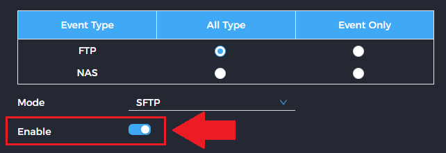

Step 2: Navigate to Settings>>Storage>>Video>>Storage and ensure the FTP protocol selected and the SFTP mode is enabled. Click Apply.

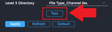

Step 3: Fill in the server address, username, and password. Ensure the port is set to 22. Enter the Storage Directory for your SFTP server. Choose your preferred Directory Structure. Using Level 3 is highly recommended for easy searching later.
Click the Test button. The NVR will attempt to log into the server. If it fails, double check your credentials and ensure your firewall isn't blocking port 22. Click Apply.
