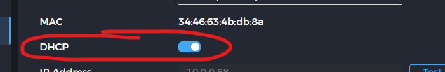

Step 1:If the camera is set to a static IP, please make sure to set it to DHCP. This will ensure the camera catches a new IP after the ISP has changed. To set the network mode of your device to DHCP, log into your camera's web UI using a browser.
Inside the web browser, navigate to Settings>>Network>>General>>TCP/IP and set the model protocol to DHCP. Click Apply.
After the ISP has been changed a new IP is assigned to your device, set the mode in the web UI back to static. This will prevent the IP address from constantly changing and disconnecting the camera due to a new IP address.
