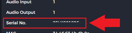

If using a POE camera or NVR and your device is connected to a network the serial number can also be found in the device's web user interface (web UI) using a web browser or using the AMLINK Pro mobile app. For more information on how to access your device using a web browser, click here.
If using the web UI on your POE camera, log into your device, click on Settings>>System>>System Settings>> General and locate the Serial Number field.
If using the web UI on your NVR, log into your device, click on System>>System Info>>Device Info>>Version Info and locate the Serial Number field.
