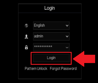

Step 1: Log into the local GUI of your device.

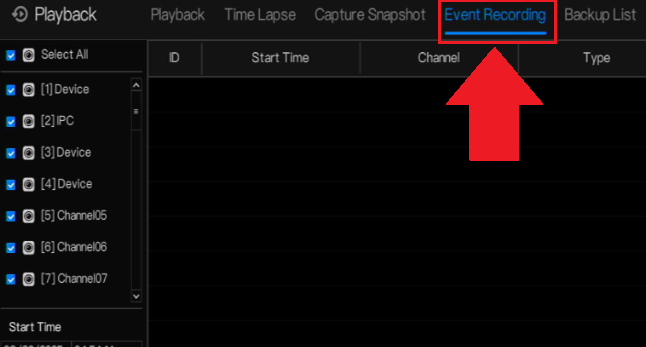

Step 3: Select the Event Recording tab.

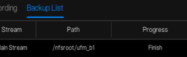

Step 6: The recording will be exported to the root directory of the inserted USB flash drive unless modified in the next interface. Click OK to export the recording to the inserted USB flash drive. The progress of the export can be found in the Backup List menu.
Once it has finished exporting you can remove the flash drive from the device and insert it into your computer to view the recording.

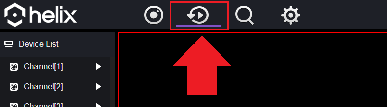

Step 1: Click Playback.
