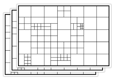

In general, the less movement in the frame the better the compression will be. This can be very beneficial to security footage since the frame is typically static. There are two major methods involved with HEVC encoding, interframe and intraframe encoding.
Interframe Encoding
This type of encoding essentially involves a comparison between previous and future frames to the current frame. In H.264 encoding the image was divided into small 16 x 16 pixel blocks. In H.265 encoding, however, these blocks are no longer stuck this size. Instead, they can range from 8 x 8, 16 x 16, 32 x 32 or 64 x 64 pixels. Each of these blocks compares their group of pixels to the new group of pixels as the frame advances. If most pixels are virtually the same, then the data from the original block is intercoded to the new frame. This means that only the pixels that have changed will be stored in the data.
Intraframe Encoding
H.265 video encoding has also decreased the amount of data stored through intraframe compression. This is similar to inter-frame compression, but instead of looking at similarities between previous and future frames, intraframe compression looks for similarities within the same frame. HEVC significantly increases intraframe predictions over H.264 encoding. In fact, HEVC has 35 different intraprediction modes (compared to 9 in AVC). Ultimately, these prediction modes allow the encoding to mathematically generate some pixel values instead of storing all of them.

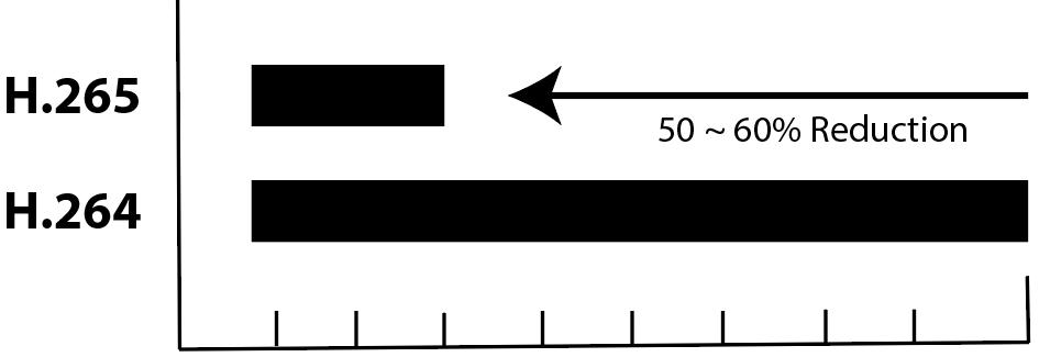

H.265 IP cameras possess a higher H.265 compression ratio compared with H.264 security cameras.
An H.265 PoE camera can help to reduce about 50% network bandwidth consumption, which helps to increase overall transmission speeds.

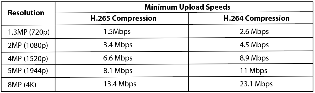

For information on H.265 compression and H.264 compression while using different camera resolutions, at their highest frames per second and resolution, please refer to the table provided below.
Note: These results are estimated under stable network conditions and may vary with your actual environment and other factors. For access to a bandwidth calculator, please click here.
H.265 IP Cameras vs. H.264 IP Cameras in Storage Usage
As the bitrate is proportional to the required storage usage, H.265 IP cameras with lower bitrate can compress the videos in almost half the file sizes in comparison to H.264 cameras while retaining the original video quality.
As mentioned above, H.265 IP cameras provide a lower bitrate than H.264 IP cameras.
That is to say, with the same storage space, H.265 IP cameras can allow for longer recording time length before the older files are automatically overwritten.
