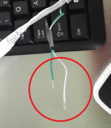

Step 1: On the wire harness of the camera, locate the reset wires attached to the unit. The reset wires will be denoted by a green and white wire.
Step 2: Touch the ends of the wires together and hold for 30 seconds. Separate the wires and give about the camera an additional minute to complete the reset process.
