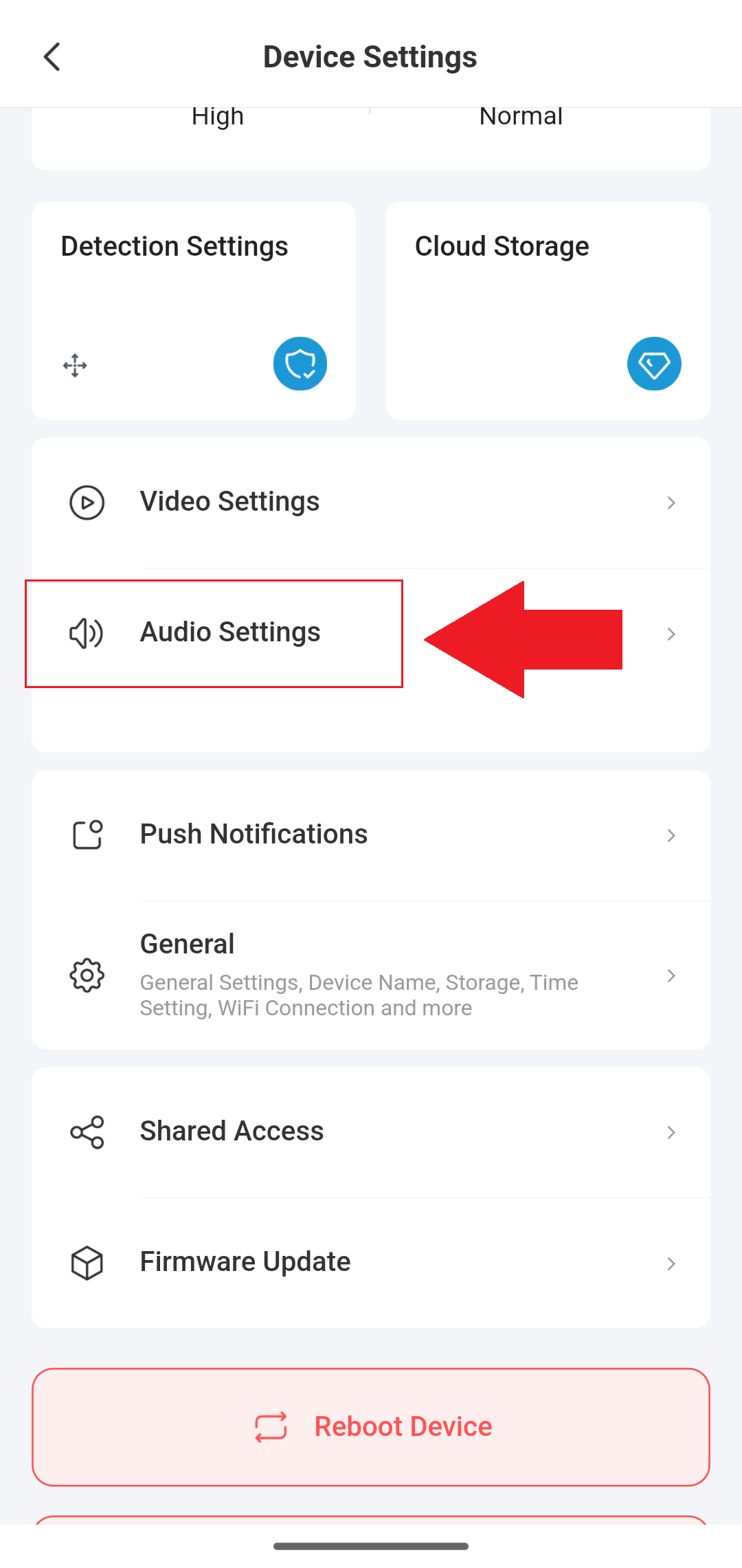

Step 1: Access the Detection Settings menu for your device. To access this menu, locate your device on the home menu and tap Settings.
Step 2: Tap Audio Settings.

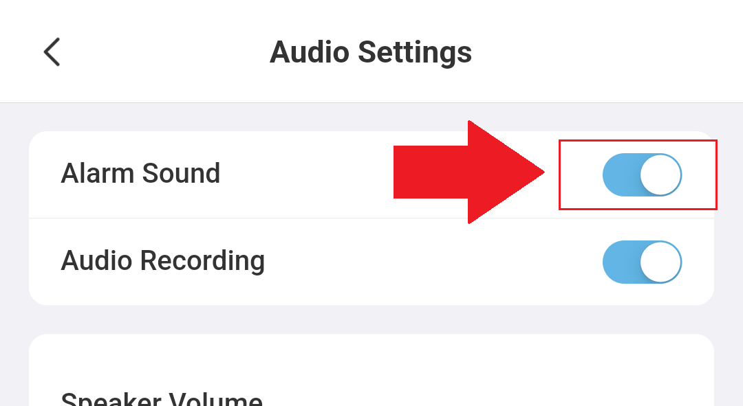

Step 3: Enable the Alarm Sound option. Adjust the speaker volume and set a "siren cycle" if needed. A siren cycle is the amount of times the alarm will sound after it is triggered. Exit the interface.
