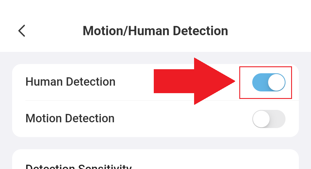

Step 2: Open the Motion/Human Detection menu and make sure Human Detection is enabled.

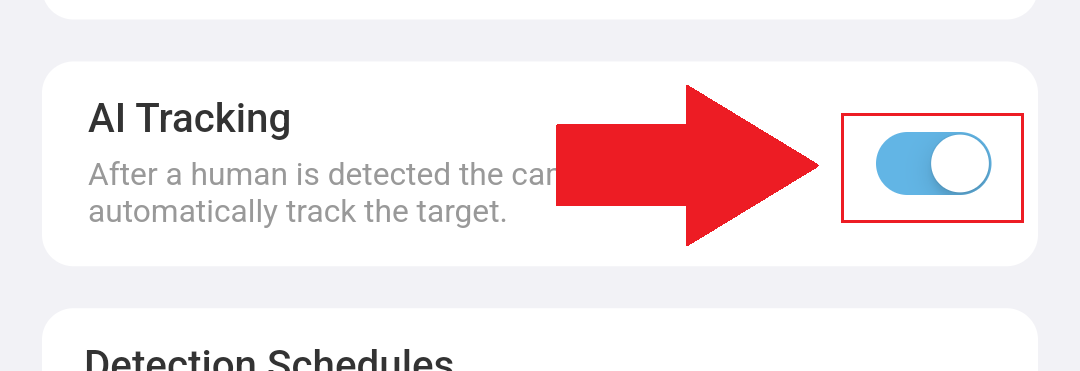

Step 3: Enable the AI Tracking option, once a human is detected, the camera will begin tracking the object until it is out of frame of the detection area.
