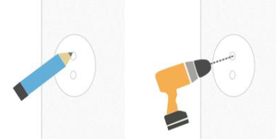

Step 1: Apply the installation template to the mounting surface and drill the holes.

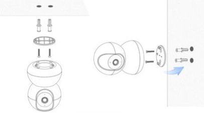

Step 2: Insert the included wall anchors and align the holes in the base. Attach the camera base onto the 2 screws to secure the camera to the surface.
