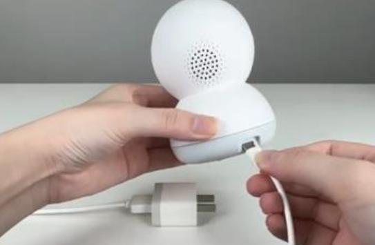

Step 1: Apply power to the camera and allow it to boot.

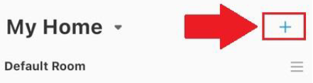

Step 3: Open the app and log into your account. Tap the “+” icon or “+ Add Device” option to begin adding your camera. If using Android, connect to Bluetooth.

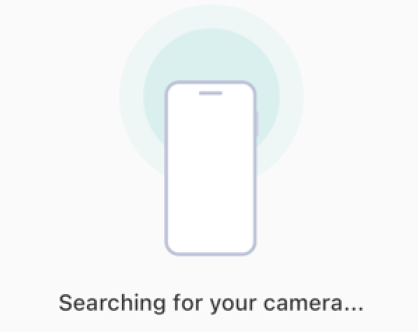

Step 4: Select your camera from the menu and allow the app to search for your device.

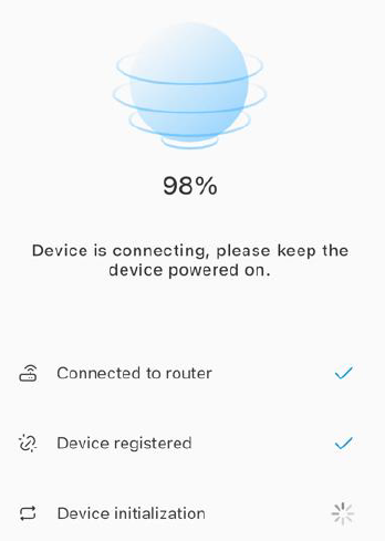

Step 5: Select your device, allow all permissions, enter your Wi-Fi network details, and allow the camera to initialize and bind to your account.

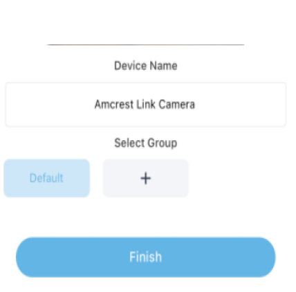

Step 6: Enter a name for the camera then click Finish. To add a cloud storge plan to your device, click the Subscribe option and sign up to an optional cloud storage plan.
